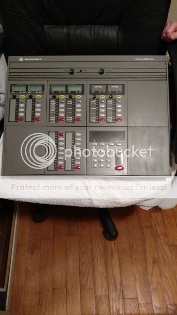

I have always wanted a dispatch console type RACK system for my radios and I finally found one. You guessed it, e-Bay. This was the video control room for a hockey team in Pennsylvania, the gentleman that had them even had his own channel on local cable systems. He retired, sold his stuff and I got a great deal on 3 19" RACK consoles. Some of my equipment bolted right in other stuff needs some TLC to look right.
