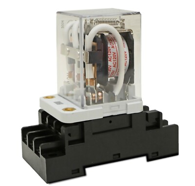

The Powerwerx thing is $190??? You can get an ok 30A solar charger for about $8 and a triple 40A contact relay (120A total!) for $19. Connect the battery and solar panel to the charger, connect the charger output to the normally closed side of the relay contacts and the normally open contacts to your power supply. Relay common goes to your radio equipment.
During normal time the power supply routes to the radio through the normally open contacts (now closed with 120v to the coil) and when AC fails the relay switches your radio to battery power. Simple, cheap and very reliable.
Here is an example of the solar charger and relay and I've used many of the same solar chargers.
