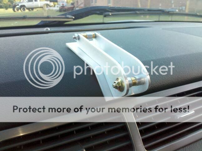

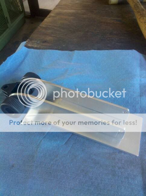

Gotta have something to hold the dash cam and GPS:
Test fit:
Some TIG welding and spray paint:

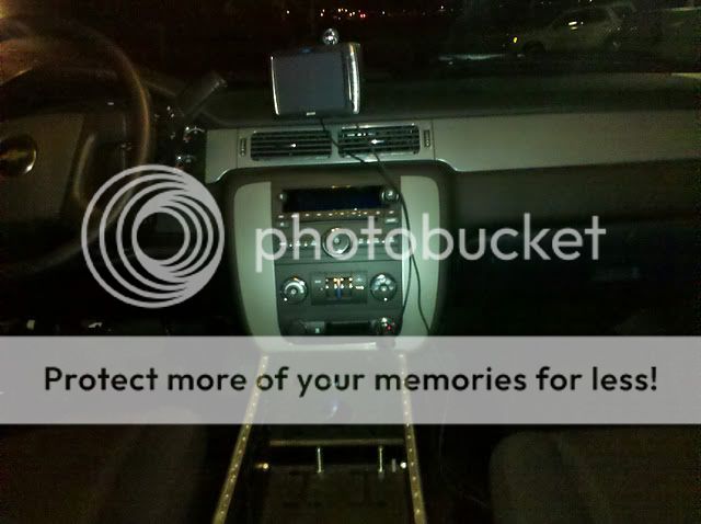

The location for the radios & controllers:
Run the cables:
Set the console base:

Drilling and mounting components to the heavy steel base of the console is just too much of a pain so I fashioned an aluminum plate to facilitate wiring. It will sit in the bottom of the front console and hold the terminal strips and power blocks. It also makes a great ground point.
And mount the console:
The console itself is shifted 2 inches left of centerline to make room for the computer mount and map pocket on the right hand side of the console. Now we play the waiting game, I have ordered the faceplates for the radios and will post more when they arrive.
