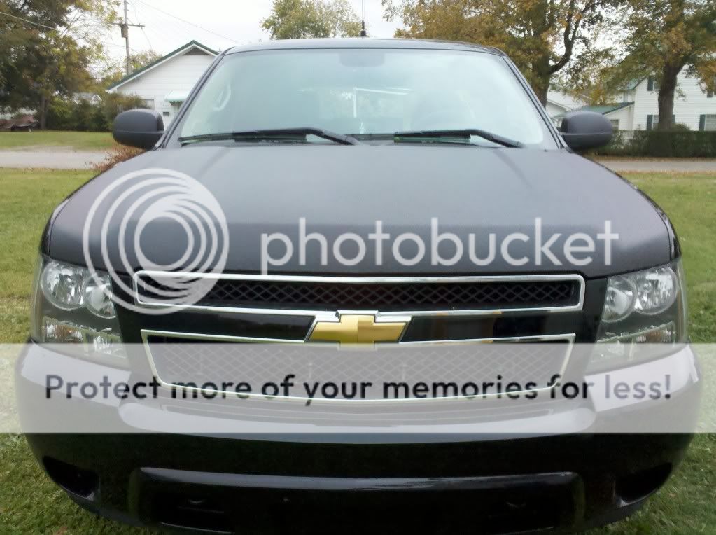

The hood is back from Armorthane! Took less than 24 hours and Patrick did an excellent job! I'm hooked, he has all my business from now on.
Let the hail come down!
