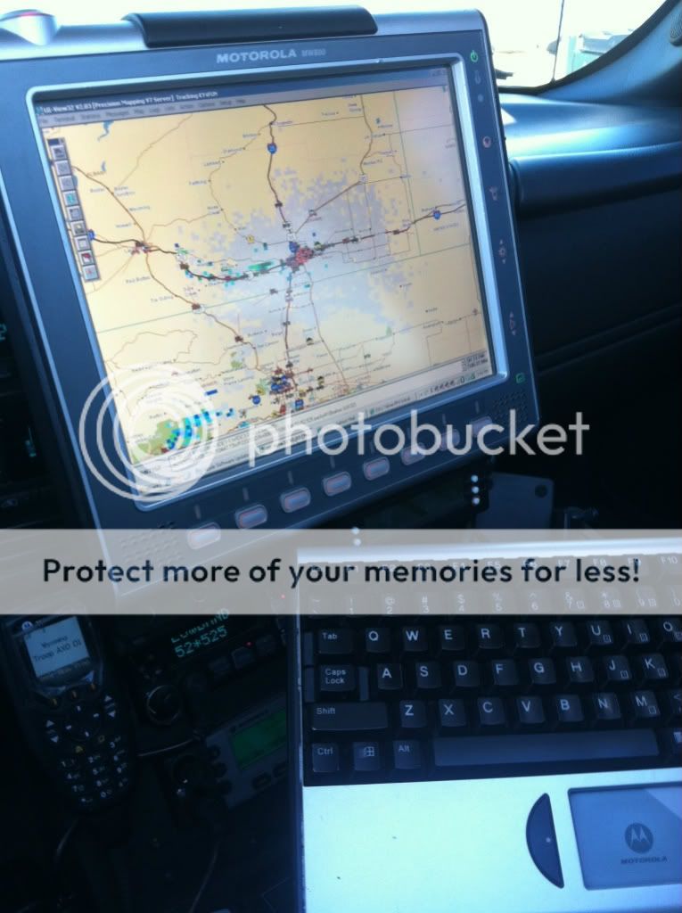

I might have a solution for you:
Reworked the GPS and D710 bracket to fit the leading contour of the dash:
Yep, that's exactly what I'm thinking about.
ProClip USA has a bracket which would let me attach something like what you've done pretty solidly to the dash in my truck.
How do you like the AvMap G5? I've been looking at the G6.
WX4EMT
Jun 17, 2008
702
Tennessee
@ RAD thank you for your kudos one "Cot Jockey" to another.
@ EMD the distance between the vent and the back of the GPS is enough to allow for good circulation. I'm hot natured to start with and there is enough flow to keep me cool even at 105 deg and in a black color truck.
@ W9 I wish that I had known about that stuff before I did the bracket for the Blazer, would have saved a lot of time. Maybe not as much fun but would have worked just fine.
As for the AvMap... If you have a D710 the perfect companion is the AvMap. The G5 is the perfect APRS companion but it is not all that great of a navigator. The scale selection and detail are just not all that. Turn by turn nav is very good but the map view goes from just a few blocks to 2 miles with nothing in between. Ironicly, I was looking at a G6 yesterday with a fellow APRS affecianado, he had traded up to the G6 for his D710 and praised it highly. Better menu control, touch screen, easy access to tactical mode, and he said it was more "Garmin like" for navigation so I'm thinking about following suite.
If you are as big of an APRS nut as I am the AvMap is definitely the way to go.

But.... can it do APRS AND nav in the same screen at the same time?
I'm just messing with you.. I really like the pic! That is an "ultimate system".
You win...!
PJH
Aug 23, 2002
3,620
Thats what windows are for :)
Been known to run:
Mobile PC
UI-View32
Garmin nRoute
GR Level 2 and 3
TX Messenger
and a few other things all at the same time
Alt-Tab and the touchscreen is your friend!
