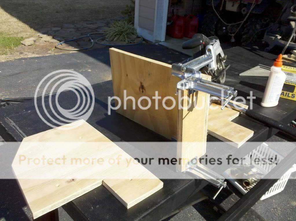

Well I got tired of waiting. I ordered the faceplates for the rest of the console over 3 weeks ago and they still aren't here. My luck hasn't changed one bit, still BAD. So I decided to recycle the siren faceplate and work on the storage console.
The angle area on the front of the console is where I will mount the control head for the Southern Vehicle Products SA-430. The top will feature a folding armrest similar to a conventional console but I am going to hand tool the leather that will cover the armrest pad. Any suggestions for a design?
My old shop teacher, Coach Berry would be proud, not because of my construction but because I remembered, "Finishing is 90% of your project because good finishing, especially good sanding, will cover up a lot of the mistakes you made in construction."
Tomorrow I'll get this thing finished and mounted but the armrest pad is going to take a long time, how about a Sistine Chapel rendering of God creating the sun and a banner:
God made PARAMEDICS because FIREFIGHTERS need a hero too!

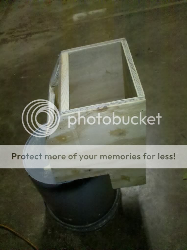

The console siren & storage area has it's second coat of bedliner and should be ready to install tomorrow if the odor has subsided. My humblest appreciation to my Lieutenant, Eric Ross for showing me some posts using bedliner for a finish, I LOVE THIS STUFF!

Mount the rear storage / siren part of the console to the floorplate and wire it up.
Yes the siren is upside down. When my arm is resting on the console the controls are right under my fingertips, just more "natural' in the inverted position.
The rear part of the console is 2" narrower than the rest of the console so I split the difference in mounting. Why, you say? Later on when I finally get caught up I plan to go with a totally on board computer system and the wireless keyboard will store in a slot on the side of the console. So... off to Tandy Leather friday to get some good tooling hide for this armrest.

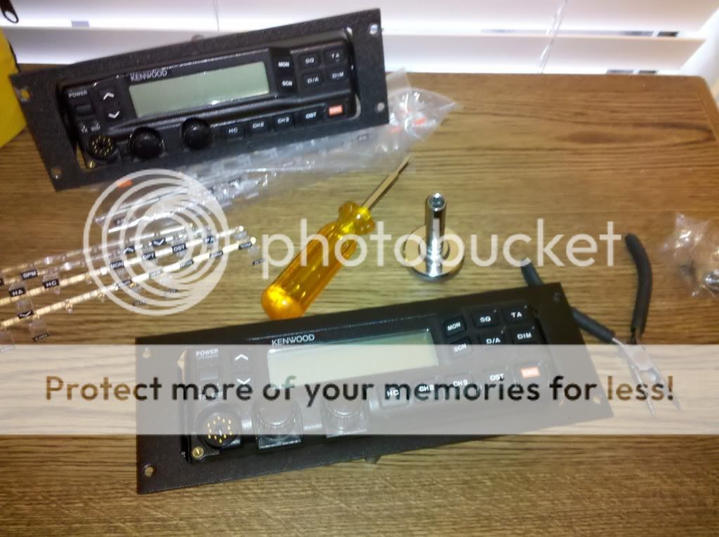

Faceplates
Over 4 weeks ago I ordered faceplates for the TK-x90 control heads and a switch panel. Low and behold they finally arrived! I managed to find another faceplate courtesy of Brian (and Adam) whom I met through this forum. Thanks guys! So here is what we have so far:

Coming together nicely, well done! Consider some cut out, black, semi-rigid foam around those control heads to fill the gaps?
WX4EMT
Jun 17, 2008
702
Tennessee
Not a bad idea Norcal, that would certainly prevent a small metallic object from causing a major catastrophy.
