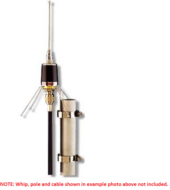

An appropriate mobile antenna will work, but you'd need the right stuff:
Add a base adapter so you don't have to do a mag mount/baking sheet thing:
Mount that to a pole/pipe/conduit and get it up as high as you safely can.
Feed it with appropriate coaxial cable for the length, like LMR-400 or better.
I'm running that Larsen antenna, as well as an EM Wave version, on my work truck. I've used it on 2 meters, 70 centimeters and GMRS. I've also swept them with an antenna analyzer and they'll give you a very suitable match on those bands.
Funny you mention this setup. A neighbor HAM down the road has that exact set up, and he even had issues hitting some of the same repeaters I am, so he had me try it to see if I got any difference but did not.
