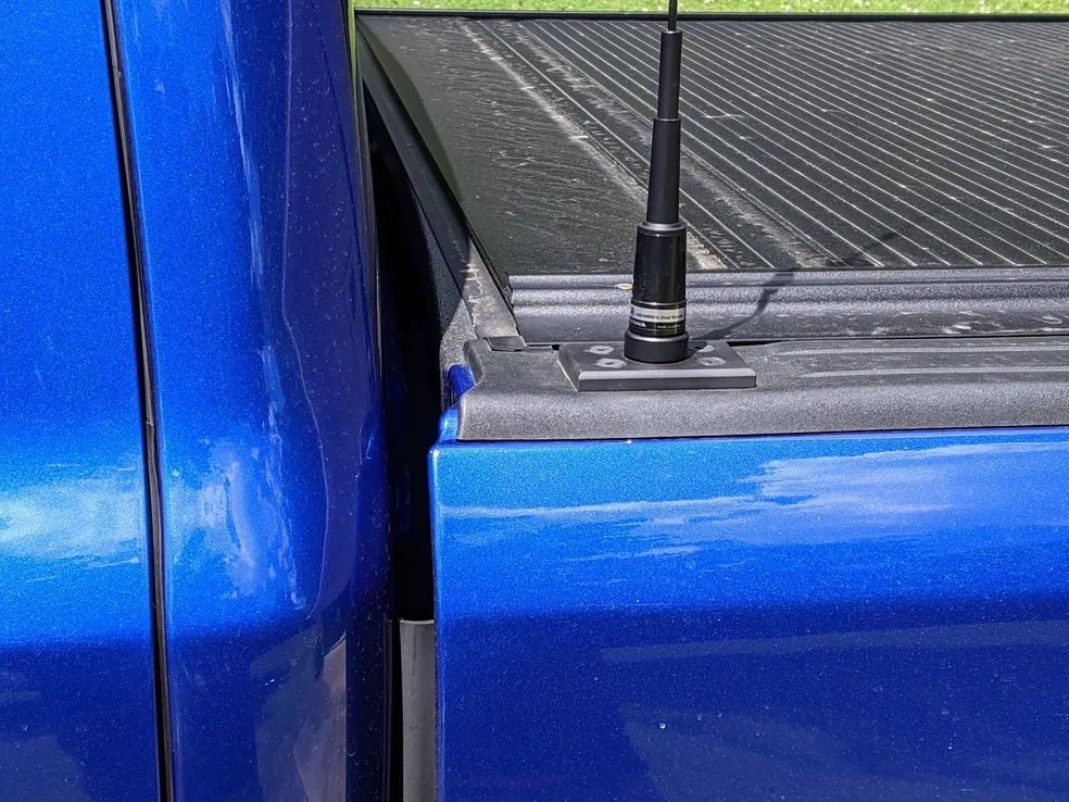

I've tried the Breedlove front rail mount, which puts the antenna in essentially the same position as the front stake pocket mount, and my experience was that the cab interferes too much with the signal to get the distance I want, and antennas just don't like it. The only antenna on any band I've found that could get an SWR of less than 2.0:1 across the entire band is a 40" whip CB antenna. In fact, that's the only place on the truck where its SWR doesn't skyrocket. The rear stake pocket positions can also be challenging, but I found that a Diamond SG7900 NGP antenna is very happy there, driver or passenger side, it doesn't matter. SWRs are well below 2.0:1 on 2m, 70cm, and GMRS and on MURS it crosses 2.0:1 at 154.6 MHz. Really a good antenna for my purposes! I also just today installed a Comet SBB225 2m/1.25m/70cm triband antenna on the rear. It isn't officially a NGP antenna, but on the driver side, its SWRs on all three bands are perfect. On the passenger side, they're off the chart. I have no idea why.
To make a long story short, I recommend you avoid the front stake pockets altogether and use a NGP antenna on a rear stake pocket mount. I just can't get good results with the antenna that close to the cab. YMMV. On my slightly-lifted 2009 Ram, the tip of the Diamond is 112 inches off the ground, but you can probably find a good NGP dual-band antenna that isn't that long. In fact, the Comet 2x4 (which is not NGP) showed good SWRs on 70cm and GMRS, but on 2m it ran 1.75-2.25:1. That probably wouldn't actually be a problem -- the 2.0:1 cutoff is arbitrary -- but I really wanted something with more gain anyway. I'll bet you can find something that works if you go to a rear stake pocket instead of a front one.

I have the dual-band Compactenna, and in a thread where I was asking about a 1.25m antenna for a poor ground plane, someone (maybe even you?) recommended it. I tried mine on a rear stake pocket mount and SWRs sucked. I don't know if you got lucky or I got unlucky, but it discouraged me from buying the tri-band one for my truck. The Compactenna runs like a champ on the roof of my car where it has a good ground plane, so if I like using the 220 band and want to put it in my car, I'll probably go with a tri-band Compactenna.
