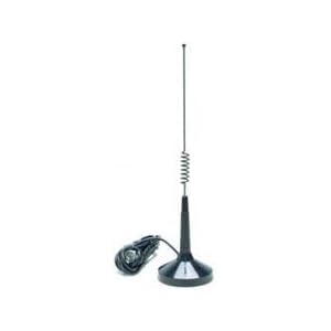

I agree with all of the above. In my limited with experience with shorty CB antennas, this design worked very well and I think it's because the loading coil is up above the base. Way back when, I remember someone saying; "Never ever bumper mount a base loaded mobile whip." and those words have always stuck. Can you buy one like this for 47mhz? No, probably not. Perhaps you could modify an existing one to work, or simply run it through a tuner. If you want it to work on a 4mhz spread, you'll need a tuner anyway, unless you're just listening to one or the other.
I was always amazed how well this design worked. I had it on the middle of my roof and if I could hear them, I could work them (locals). YMMV
