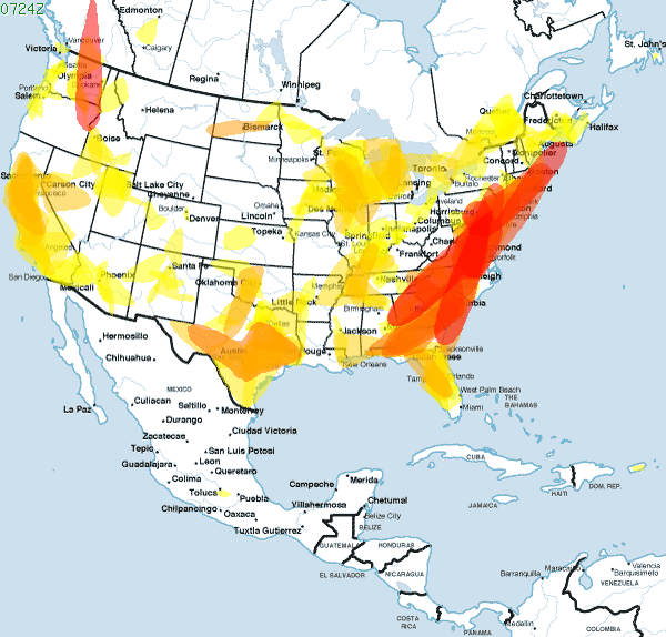

Here's a cool site I came across a while back: http://www.mountainlake.k12.mn.us/ham/aprs/path.cgi?map=na it shows real time activity of APRS. Since every packet contains Lat/Lon and the recieving stations know thier lat/lon it can show band openings. Right now it looks like the entire East coast is open north to south.
also you might check out dxinfocentre.com where the guy has forcasted openings just like what you would see on the weather channel
