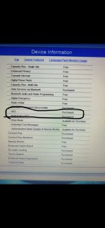

I know moto dmr radios do not support AES
XPR3xxx/4xxx/6xxx series do not support AES encryption but the XPR5xxx/7xxx series and newer definitely do support AES. Both my XPR5550 and my XPR7550&7550e have AES encrypted channels in them.
