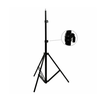

I have a DPD Production's MilTenna OMNI mounted on a 9ft inexpensive light-stand in my office, works great! VHF/UHF too! My office has a 10ft ceiling.
