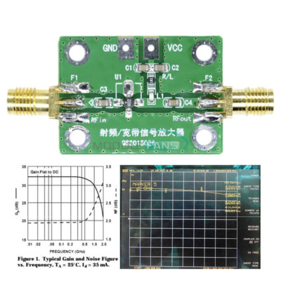

I should have specified on the voltage. The LNA I have states 6 to 12 volts and I run it at 6. I definitely think I want an adjustable attenuator. Just have to figure out which one.
Usually there's a voltage stabilizer in the amplifier that supply 3,3v or 5v to the actual amplifier device and then needs to be powered by at least 6v. Are you sure that the noise (and gain) increase at 12v? What amplifier is it? ScannerMaster has an adjustable attenuator with BNC connectors, that's the easy way to get one with the correct connectors.
This is it. I do want to get the nooelec, rtl sdr or pga 103+ as anyone of those would most likely perform better.
Yes, you are right, at both accounts, it will change gain with voltage. It says max output +10dBm and has a 30dB gain. So extremely poor specification as PGA103+ and even Stridsbergs have at least +30dBm output and can tolerate higher signals much better. Remember that if you have no filters before the amp it will see FM broadcast, TV, cellular towers and everything else at its input and will overload very easily.
/Ubbe
30dBm output or IP1 would be 1 watt. Stridsberg rates their amps at 17dBm IP1, which is only 50 miliwatts, a far cry from 1 watt. The MiniCircuits version of the PGA103 seems to be the ZX60-P103LN and its rated around 22dBm IP1 or close to 158 miliwatts. Still way less than 30dBm. The MiniCircuits ZHL-1010 I like to use is rated 26dBm IP1 which is 398 miliwatts and works in places where the Stridsberg would fold up and die.
