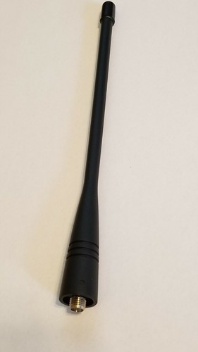

I am in a similar situation. I monitor a system that i am on the edge of.
By watching the error rate i found that putting a full size motorola antenna on the G4 gave me better results than using an external 800 antenna. For my testing i had a mag mount antenna with one of those older what we used to call pig tail antennas. They have the curl half way up. Not the most scientific test but i found what works for me.

I was using one of these when I had my G5 which was recommended in another thread a while back and it was an improvement and did not affect the center pin.
Disregard, I didn't realize you meant the base
