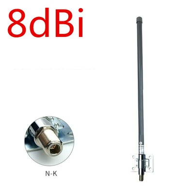

Well you will need an Omni antenna then. Here are some choices,
Don't forget you will need coax cable to connect from the antenna to your scanner, the shorter the better. Once you decide on what antenna you will get we can help you with the right coax to order, you can get custom lengths made from the same seller. That is a good option if you already know where you will mount the antenna and where your scanner will be.

For 800MHz this antenna would be hard to beat for the price. It probably doesn't have the advertised gain but at least you can compare its size with others.
