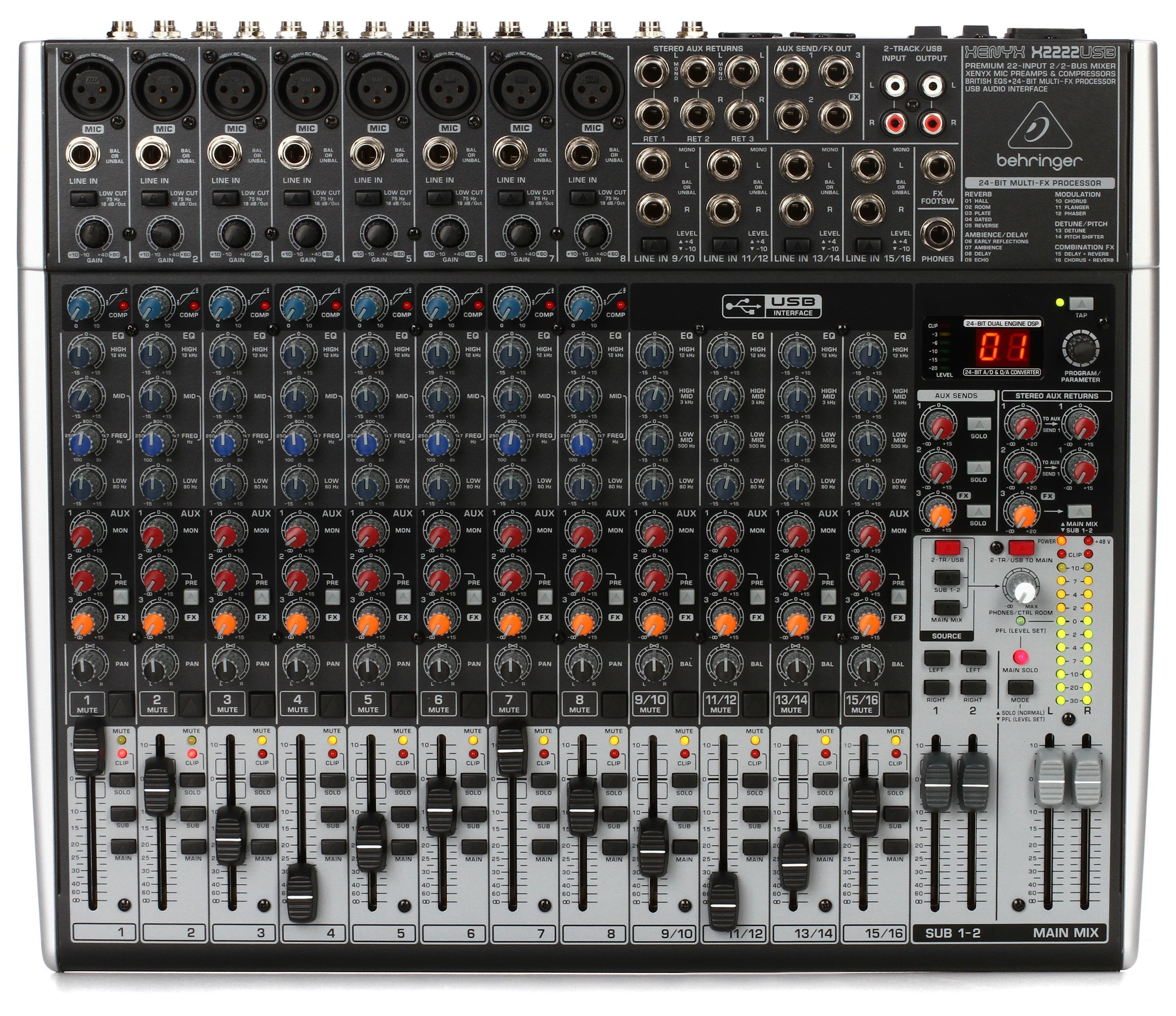

My IT guy (son) said the Behringer X2222USB was the best for my needs, thanks for the suggestion! I ordered one tonight, should be here Friday.
One question he wasn't sure of: Should I get 1/8 stereo to 1/4 mono cables, stereo to stereo or mono to mono cables? According to the 996 manual it outputs to a mono jack for the External Speaker jack and I assume the same for the 536's and SDS200. As for the Icom's (IC-7300, IC-705 and R8600) I will have to figure them out.

There's a company called Hosa that caters to the pro audio biz. They make a cable that is 1/8 TS (aka "mono") on one end and 1/4 TS on the other end. Sweetwater carries this cable in a couple different lengths. With a few exceptions, most of the radios you deal with have mono audio outputs. For example of the exception, the IC-7610 has two receivers and a stereo headphone jack so one receiver is on one channel and the other receiver is on the other.
On that Behringer, channels 1 through 8 are mono and 9/10 through 15/16 are stereo. The stereo channels can take either a mono or stereo input and if you just plug into the Left channel, you'll get mono. That mixer has some nice routing features that will let you send each channel to the MAIN faders or the SUB faders. The SUB faders can then be routed to the headphone jack or to the MAIN faders. I think that whatever is on the MAIN faders also appears on the USB to your computer. You can route audio from the computer to either the headphones or the MAIN faders. Channels 1-8 have a "sweepable" or "parametric" mid range EQ control plus Bass and Treble. Channels 9/10-15/16 have a High Mid and a Low Mid EQ plus Bass and Treble. Channels 1-8 have a "one knob compressor" that adjusts two or three compression parameters simultaneously. Watch a few YouTube vids and you'll get the hang of signal routing and adjustment.
And it's still got effects loops, so you could mix in roger beeps and echo chambers to really trick out the audio..... :D
I'd use the headphone jacks as it's a lower level audio and not likely to wipe out the input preamps on the board, or at least cause wildly distorted audio. It will also be much easier to tweak the level of the input audio to the board; minimum level audio from the speaker jack is often hot enough to overdrive the inputs on your board (I speak from experience).
As far as stereo vs mono, you'll have to test; thanks to the proliferation of cheap stereo headphones many radios these days are using stereo headphone jacks. I tried using a stereo plug on my Icom 7300 with no luck, but when I switched to a mono plug it worked fine. Vice-versa on one of the scanners. The other thing you could do is standardize on cables with 1/4 mono on one end and 1/8 stereo on the other end, then use 1/8 stereo jack to 1/8 mono adapters where needed (I use these all the time).
Also make sure to use decently shielded cables.
