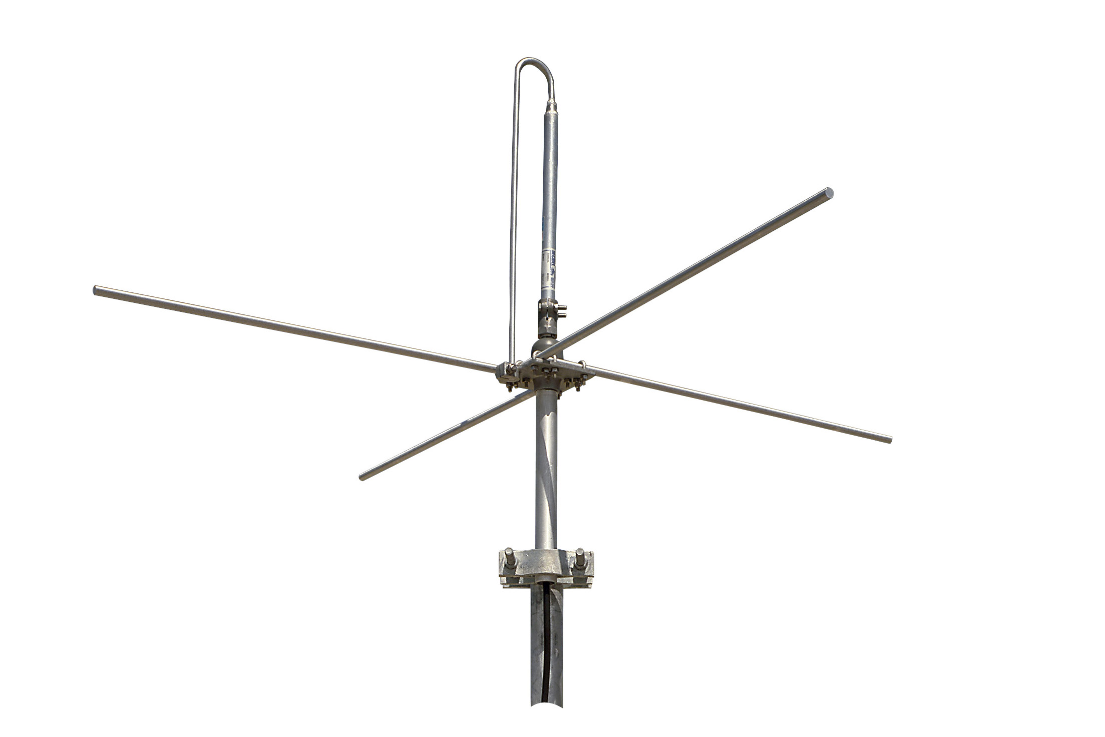

I think a ground plane with a grounded hairpin loop vertical element would probably cover the entire VHF air band and would be easy to make. Its just like a regular ground plane except the vertical element makes a U turn and heads back down to the feed point where its grounded. Here is a commercial version that's rated at 2% frequency band width, so if you use 127MHz as the center of the band it should cover 114.3 to 139.7MHz.
The commercial version uses thicker elements than a home made job using maybe house wire or brazing rods, but I think it would work fine over the 118 to 136MHz range compared to a J-pole or simple ground plane. So who wants to make one and report on how it works?
