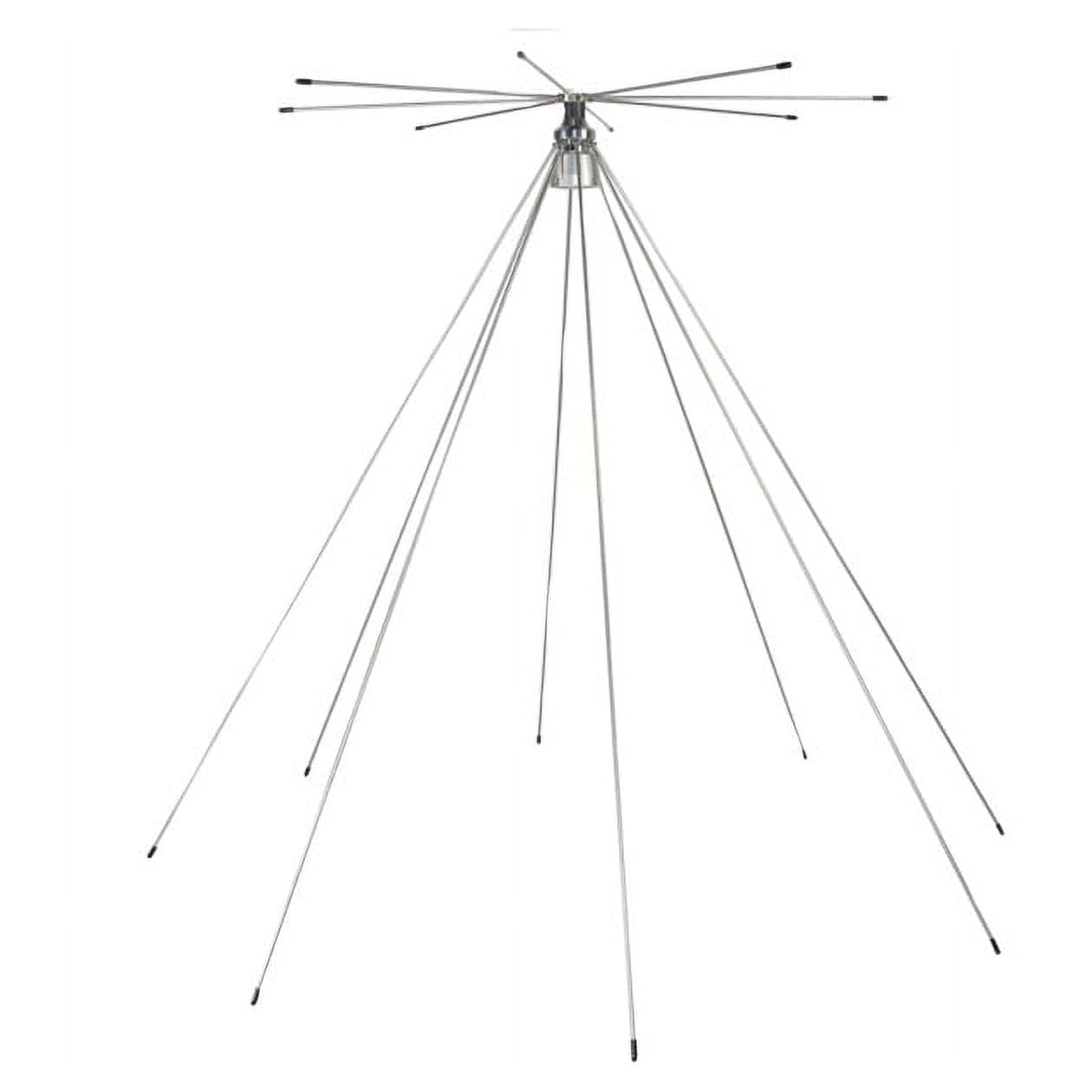

I'd like to set up an antenna that will give me the benefits of having a base/mobile station with my handheld. I'm assuming people do this and just wire the coax to their handheld.
Right now, I'm on the fifth (top) floor of a building, however, I believe that signals coming from behind me (other side of the building) are being blocked/dampened by the concrete/brick. I would like to set up a decent, small to mid-size antenna that I can stick above my balcony onto the roof, so I can get good signal reception from all sides.
Does anyone using a handheld with base antenna, or anyone else have any opinions, thoughts, or tips on where to start? I'm fairly new to radios in general so I appreciate any advice I can get.
I get fairly good reception with the stock BCD436HP antenna for my 800mhz channels, so, ideally, I would like an antenna that will give me the best ability to find new signals I previously couldn't get.
I would say 800mhz, 200mhz, and 400mhz are the top three bands Im looking to receive, but I'd like to be able to get better reception on everything from 20mhz-950mhz (although I know this isn't ideal and best remedied with a single antenna for particular band).
From research so far, it seems like discones are a popular choice for this kind of objective. Would this be my best bet, or are there others better suited? I'd like to make it myself to save money and have a project to do as well.

Discone antennas are a good choice for wide bandwidth, they'll match the frequency capability of your radio. They are not the "best" antenna, but a good all around option.

However, since I don't need an antenna for those bands, I can now focus a bit more on a smaller range, so is there an antenna type that would outperform a discone, but still give me a somewhat wide range, perhaps 300mhz and down?
My budget is not very large for this, and these $50~ discones look attractive price-wise, but does anyone know if they are any good? THey seem to have pretty good reviews.

I'd carefully consider your budget. Those are pretty low tier antennas. If you are going to be moving them around frequently (putting them up, taking them down at night), you are probably going to have issues.
MFJ is an amateur radio brand know for low cost/low quality products. The joke is M.F.J. = Mighty Fine Junk.
Tram is also a low tier brand.
Never heard of Harvest.
I understand the desire to keep the costs low, but if you spend $50 on an antenna and end up replacing it with another one in 6 months due to failure, wouldn't it be easier to just buy a higher quality antenna now?
Diamond makes some decent discone antennas. They'll cost some more, but will last longer. I scored one for free about 10 years ago and it's still up on my roof. Have not had any issues with it.

Of course, if they are junk then it's not worth it, I agree. I just wasn't sure if it was a brand-name price difference type thing. I believe I saw a Diamond discone for about $100, which is reasonable.
Over $100 I'd really have to evaluate if it's worth the money (or make a little side fund) just to be able to hear random things since all the local public safety, hospital, aiport, and amateur comes in crystal clear. I'd like to try to get some of the stuff just out of range like military and forest service, environmental, statewide/federal, as well as just finding new stuff I haven't yet seen.
If I can get a good deal on a diamond, then I think I'll do that. I do want to make one, but I think for my first one + lack of knowledge thus far, I should just buy one that is guaranteed to be made right.

Starting with a known good antenna and cable is a smart idea. Discone antennas are not easy to make on your own, at least not for your first antenna. Not impossible, but takes some time and skill.
If you want to try making your own antenna, do some searching on quarter wave ground plane antennas. They are frequency specific, so you can make one for specific parts of the bands you want to listen to. Since discone antennas have no appreciable RF gain, and neither do quarter waves, they'll work just as well. Drawback is the quarter wave antennas are (mostly) band specific. The benefit to a discone is they cover a wide amount of spectrum equally poorly.

Tram is a budget antenna, but it's fine for indoor use. I'd go with a higher-tier antenna if it was going to be installed outside, but for indoor/attic installation, its more than adequate.
