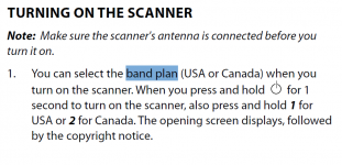

Canada Band Plan FREQUENCY (MHz)
LOWER UPPER STEP (kHz ) MODE
25.0000 27.9950 5.0 AM Petroleum Products & Broadcast Pickup CB Class D Channel Business & Forest Products
28.0000 54.0000 5.0 NFM 10 Meter Amateur Band VHF Low Band 6 Meter Amateur Band
108.0000 136.9916 8.33 AM Aircraft Band
137.0000 174.0000 5.0 NFM Military Land Mobile 2 Meter Amateur Band Military Land Mobile VHF High Band Federal Government
225.0000 380.0000 12.5 AM Military Air Band
400.0000 512.0000 6.25 NFM Miscellaneous Federal Government Land Mobile 70 cm Amateur Band UHF Standard Band
