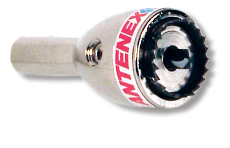

Now, the pillars on my car would allow a 3/4" hole (such as with an Antenex HS34 hole cutter:
and the inside trim panel for the pillar provides direct access to the pillar metal frame, so I could run the RG-58 wire behind the glovebox (coming from the passenger's side pillar) to the scanner radio in the center console ISO 7736 / DIN slot.
This way I don't have to drill through the firewall of the engine or worry about antenna wires having kinks crimped in them by a trunk or hood. And the black finish will look like it was factory installed.
