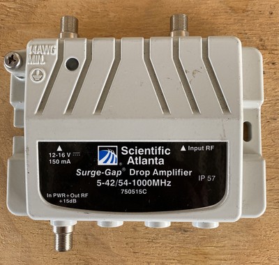

My mast mount preamp is Scientific Atlanta 750515C drop amp. 15Db gain 1.2 Db noise 50 Mhz > 1200 Mhz
$5 on ebay.
Typical SDR won't power it (3.3V) takes external inserter and 10>16V.
I use switches for 2 antennas, DiSeqe control in front of that.
45' RG6QS to a preselector with 0>30Db attenuation,band pass filtering, another 10Db gain stage then to the receivers.
The SA drop amp will certainly do you justice.
Spares I have on hand:
