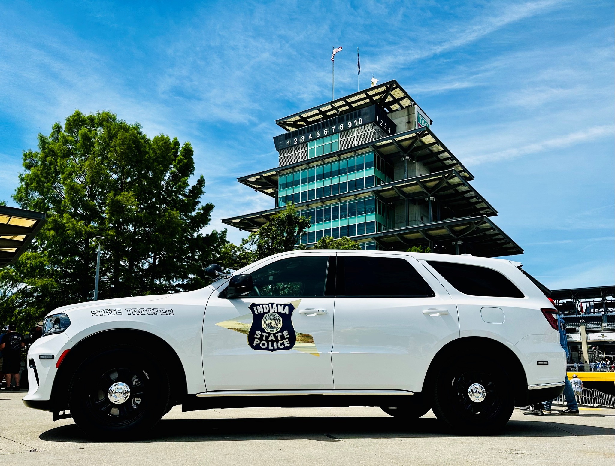

Will vehicles with the same colour of the pavement be in more crashes?
I think the Czechoslovakian VB had it right with the white and yellow paint on the cars.
Yup. It's about visibility (reflectivity), with black being about 10% more risky than white.
I like how they admit the dark colors are about being stealthy. :) We used to call them slick-tops, though the ultra-flat light bars in recent years have blurred the distinction.
