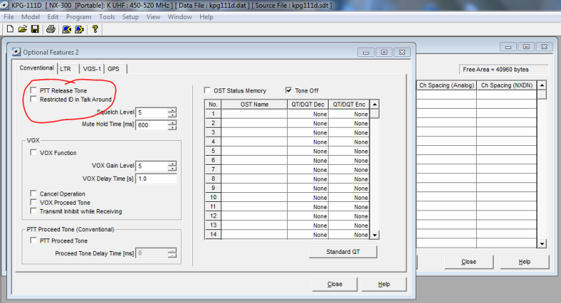

I'm using 111D which is the program for the NX series radios, but on my Optional Features 2 menu screen I have a check box for PTT Release Tone. Check that.
