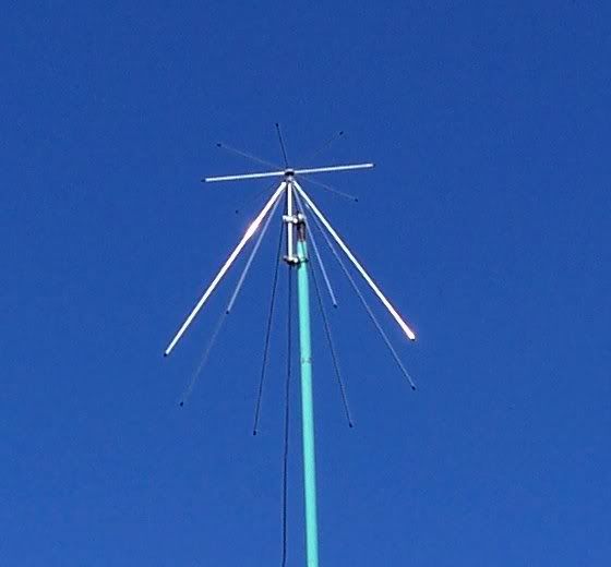

That's the list I was looking for, thank you. Little disappointed now though. I can pick up Midway, Sax and Whyte but no Hibbing, Chisholm or Ely. Hmmmmm.
Looking at pictures of antennas I see they have a single vertical element on top, mine doesn't have that. Does that really matter?
This one is about 30' off the ground.
Thanks
I believe the vertical element usually adds VHF Low (~30-50Mhz) to the discone type antennas like that.

Looks like you could use some thicker low loss coax on your antenna.....
I went out and looked and can't find any lettering or numbers at all, just some yellow >>>>>> the length of the cable. It does have factory ends on it but seems a little smaller than the RG-6/U I installed for my cable internet and TVs.
Once spring arrives (little chilly today) would the RG-6/U be a good replacement for the 20+ year old cable? I ordered 250'....the sticker on the box said 250".....it contained 500' so I have a lot left. I have the tool for compression fittings so I'll have to find them.

I guess if you have a 50' or less run it will work ok....you will just have to test it and see if u get the results you want....
I think I have 28' max right now.

.....Once spring arrives (little chilly today) would the RG-6/U be a good replacement for the 20+ year old cable?.....
While the RG-6/U would be okay, I would suggest 9913 or better because there is so much loss in feedling at 800 mHz frequencies.

There would be about 1.5 db more loss with rg6 compared to lmr 400 with a 30 ft run... Make some notes on what you hear and how strong before and after u install the new stuff !
Thanks
If you really want a good antenna I would go with the ST2 its awesome compared to the Discone I had that one before the ST2:) I would recommend if you have money to get it and it works great with the RG6 that comes with it:) LOVE AND BLESSING

Does anyone have an opinion on using 75 ohm RG/11 cable instead of RG/6, we use it in the cable industry for lower attenuation on the higher freqs for longer runs. I was thinking of using it for my scanners roof antenna since I have it at my disposal. I imagine it would be better than RG/6. Any downsides?
NDRADIONUT
Jan 9, 2005
1,952
3
FARGO ND
The f connectors on rg6 are lower loss than the pl-259's you would have to use on rg 11 but the rg 11 cable loss would be a little less...a toss-up maybe....
