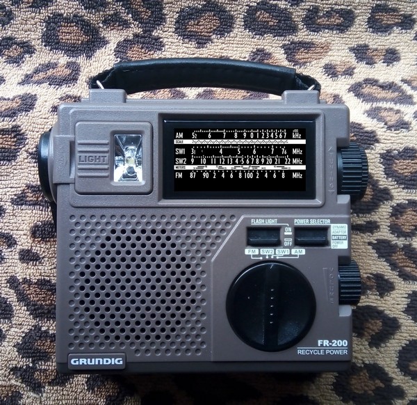

custom dial for Grundig FR-200
wenzeslaus
Aug 30, 2023
149
64
Grundig FR-200
made a new dial, it would look like this
closeup
need to print it out, laminate, and install
still got some room at the bottom. don't know what else to put in there.
