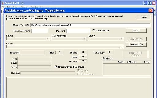

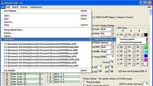

I use WIN500 for my PSR-600 and that same software can be used to program the Pro-106. Below are graphics showing the steps.
1. Open the software and click on File then point to Web Import > RR.com > then select Trunked Systems or Conventional frequencies.
2. Fill in your credentials as if you were logging into RR.
3. Click Start
4. Select the Country > State/Province > County from the drop down menus.
5. Select the System from the drop down menu and enter System ID and any other information needed for the system you are after.
6. Click Import This System.
There will be other selections and other pages with selections for you to make before it actually imports the system(s), but once you have the program populated all you need to do is upload it to the scanner. Very fast, very simple, very easy. The other programs work in this same fashion.
