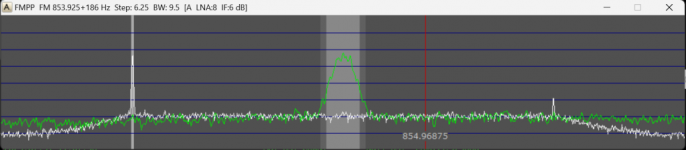

Thought I'd give you guys an update. I received my Airspy R2 yesterday. Hooked it up this morning. Created a .BAT file with the correct S/N. Fired it up and everything working great. Currently monitoring my local county P25/P2 system using a single device for CC/VC and the "Voice/Data Call Following" option. Very pleased with this. It rivals my SDS100.
Now I have to figure out how to create the appropriate data files to get alpha displays that give me correct information about what is being decoded. So, a question - is there a way to take existing SDS100 files and convert them to the correct format for DSD+? Just thought I'd ask here before I go through the trouble of manually creating and/or converting. I haven't done any research on this question yet, so the answer might be out there and easy to find - just wanted to throw it out here, too.
