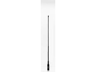

I would just use the preprogrammed Service Search for railroads. The BC125AT searches fast enough that you won’t miss anything.
Be sure to get a better antenna to replace the one it comes with. A better antenna will make all the difference in the world when scanning railroads.The Diamond RH77CA is an excellent choice.

But I plan to try it out on a road trip to northern Ohio next week, to railfan Berea, Bellevue, Vickers (Northwood), and Fostoria.
As far as antennae go, can you find these off the shelf somewhere or will I need to buy online? I’m leaving for Ohio Monday so I don’t have a lot of time to shop for one.
DX Engineering has a small showroom and retail store in Tallmadge, Ohio, which is about 45 miles from downtown Berea. About Us
They have the antenna that Whiskey3JMC mentioned: Diamond RH-77CA
