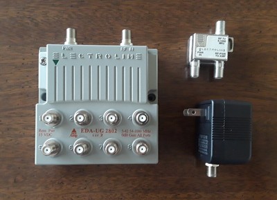

Just picked up my second Electroline FM Amplifier. Good from 1.5mhz to 2.0 Ghz. It's a 2 way. A lot cheaper than the Stridsberg.
It is rated at +11db Amplification on each output.
My question, What is the signal loss "receiving only" scanner use, using 30 feet of RG6 from a UHF Antenna with Ground Plane in the attic to the amplifier at my scanner feed PC. The scanners are both BC125ATs. The line loss calculators online only do transmit loss.

+11db wow that's pretty high for the front end of a BC125AT! I use the electroline 8 ports and they are only +4db enough to make up for the 1 to 8 split. 30 feet of RG-6 is almost no loss for a scanner. If you find you aren't hearing much try the FM trap or bandpass filters. I've tried that 1 to 2 electroline, in fact sitting here in my drawer, way too hot for my area. Fort Lauderdale probably just as busy with cell towers radio stations etc' etc'. Good luck let us know how it works.

I'm running an Electroline EDA 2800 8 port (4dB gain per port) amp from a DPD OmniX antenna at about 60' elevation (12' mast on a 4 story building with an attic + ~50' LMR400) in North NJ and it's pulling in strong! I have it split to 4 Moto radios, a DS200 and 3 SDR sticks) and I'm receiving public safety systems 70 miles south (Jersey shore) and Coast Guard Sector South New England. I just repositioned the antenna last week so I'm still testing it's limits.

The problem I've seen with these type amps is they don't really work for low band VHF.
These cable tv amps all have a lower cutoff at 42 MHz for reception. They will pass 42 MHz and below back out to the cable company but will generally block it incoming. This is because today's cable tv systems are two way sytems with the frequencies below 42 MHz used for the return signal back to the cable plant.
If you don't monitor low band below 42 MHz, then they can help depending on the overall RF levels in your area not being super strong to just introduce overload and odd mixing products from the amp.

I run the 8 Port 2800 (+4db each) for my Scanner Rack from a Tram Discone and a Yagi 800-900mhz into a Comet duplexer, with one RG-6 cable about 20 ft run into the 8 Port 2800 Electroline and then the 2 Port (+11db each) for the Broadcasify Feed UHF 450-460mhz from a 2nd dedicated Discone Antenna just for that feed. All 3 antennas are in the attic.
