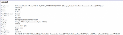

SDRTrunk outputs an mp3 (or WAVE). The mp3 has the following metadata.
Note the "Decoder" field in the comment section. Phase 1 or 2
