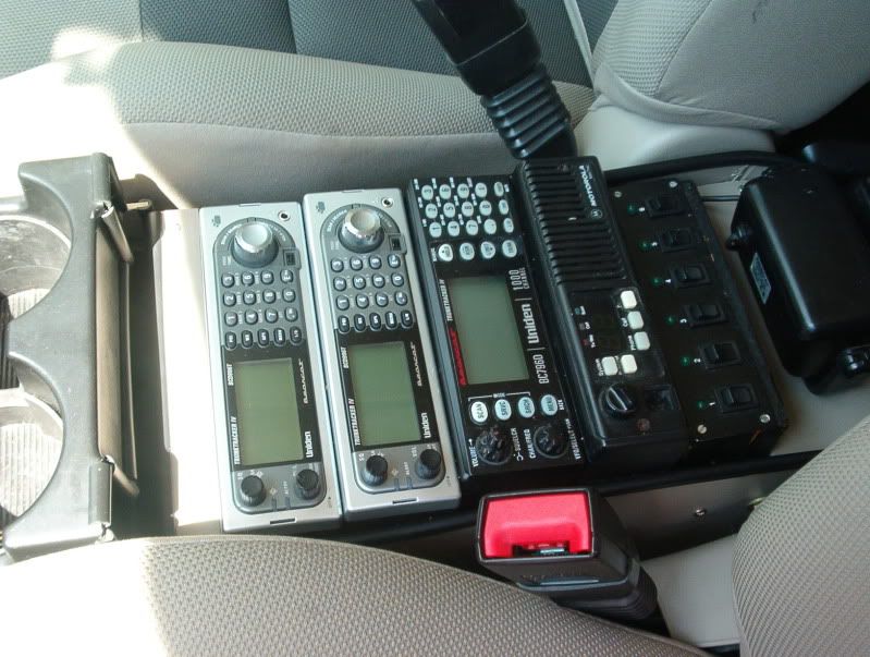

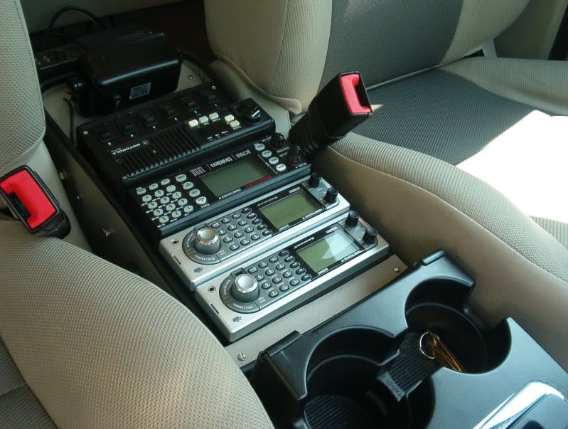

Here's some photos of my 08 Escape.
This is the salvage console that I modified to mount my radios.
Mounted are: (2) Uniden BCD 996T's
(1) Uniden BC796D
(1) Motorola MaxTrac 800Mhz 16 Ch
(1) 6 unit power control box
(1) GE 2-way 450.00 Mhz 2-way
(1) Uniden BC 296T Handheld

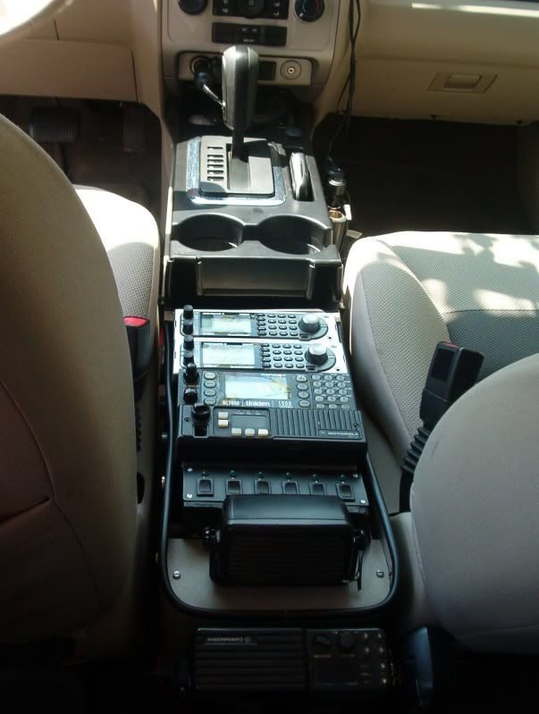

My 2006 Ford Explorer
These are pictures from last year. I have since swapped out the BC796's for 996's.

Looks good however I'm on the fence about the consoles in the newer Explorers with the floor shifter.
Is that the Jotto Desk console? I see the elbow pad at the back of the consoloe, but how many times has your elbow bumped one of your switches?
I see you have a RAM computer mount. I had a Jotto Desk computer mount in my Explorer, but never liked it. When I set up my Expedition, I bought a RAM mount. Much better IMHO.
Yes, this is a jotto console. I don't like it oo much. The display on the scanners gets hard to read when you're driving. The switches don't get bumped by me..but..my wife ..all of the time! I took the computer out of the vehicle due to it was more of a P.I.T.A. when it was time for a family vehicle. I got sick of removing it so it went to the basement spare parts box for now.
I do however like the console because of my last truck being a GMC Jimmy. I had to cut and hack to get the scanners and radios to fit in it.
