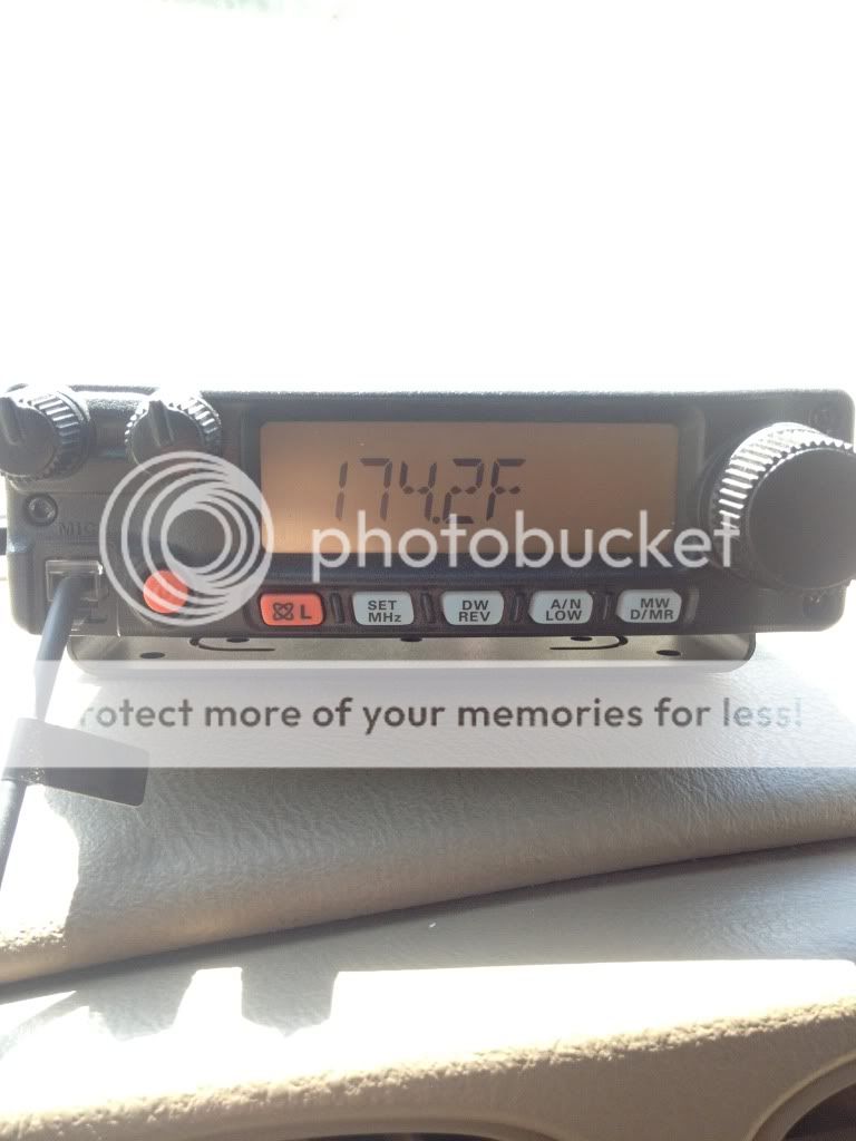

The FT-2900 will narrowband (mine would). Like any mobile radio these aren't built for more than about 25% duty at full power (most commercial rigs are only speced at 10-15% duty). Did I ever melt down my 2900? No but it did get hot enough on several occasions, according to the internal temperature probe, that it concerned me. Somewhere around 175 degrees F is as hot as I ever let mine get (once it was that hot just turning it on). I found that turning the defroster on (mounted on top of the dash) really helped with moving heat away from the radio.
I rarely took mine above the 35W setting, usually ran with a 1/4 wave antenna. Later upgraded to a much smaller Motorola PM400 before upgrading to my new radio...but I prefer commerical gear (even more for FM base as you rarely need to add new channels).
These were taken on the same day when I got into the vehicle.
