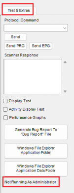

The setup program runs as administrator but ProScan does not when clicking the Finish button with the 'Launch ProScan' option on. I added an indicator to make it easy to tell if administrator or not, in the next version 23.1 not out yet.
{edit} I think a 2nd UAC prompt will appear if ProScan did start as admin from the setup program.

My oversight. I just tested with 23.1 and as noted it does indeed drop privileges back to the normal user account after "Launch ProScan" is run when setup finishes. Thanks!
