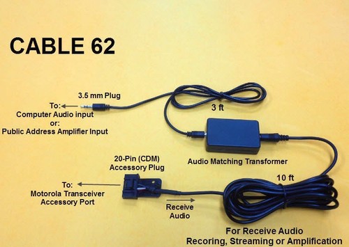

This is a small set up but it's all I need to broadcast the 25/28/32 precincts in Harlem. I live in a 6 floor walk up so I have amazing reception of my home precincts. I'm located in between the 25/28/32 and the 26/30 precincts in central Harlem right at the east and west side divide, so I get the best of every call especially in the summer.
I am attempting to run the feed using cable 62 to an CDM1550ls to a dell xpr laptop that's running windows 10.
The problem is the radio only broadcast static. And I am unsure why?
The funny thing is that I can hear the muted mdc tones clear but the voice is complete static.

How are you making an audio connection to the radio? You do know the CDM speaker amp is a balanced arrangement that requires an isolation transformer to connect to an unbalanced load like a sound card. You can damage the radio if you ground either of the speaker leads.

Cable 62, is that taking the low line level signal from the radio? But it sounds as if it's still too much for the computer. You'll need to attenuate the signal or try to change the line in setting on your computer to match the level from the radio.

This is the cable I'm using. What should I be using?

Use a russound speaker level to line level converter $20 bucks. You will need a rca stereo to 3.5 mm stereo to introduce into computer as line level. The more money option is adjustable preamp.

You are using the correct cable. Check that you do not use "mic in" on computer, use the blue "line in" and adjust the level by right clicking on the loudspeaker symbol and choose recording.
