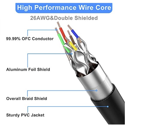

Replying to this to hopefully help others that might have the ethernet interference...
I tried a flat cable that I had bought a while back before I had this scanner, it was a real cheap one, and that didn't help at all... So I bought this Shielded Cat 8 cable:
Amazon.com: Cat 8 Ethernet Cable 50 ft Shielded, 26AWG Lastest 40Gbps 2000Mhz SFTP Patch Cord, Heavy Duty High Speed Cat8 LAN Network RJ45 Cable- in Wall, Outdoor, Weatherproof Rated for Router, Modem, Gaming : Electronics
That also didn't all, which surprised me...
However, the same manufacturer makes this flat cable:
Amazon.com: Cat8 Ethernet Cable 50FT-Black-40Gbps Shielded & GND Solid Cores Internet Cord for Long Distance,High Speed Flat Network Computer Cable LAN Wire with RJ45 for Router,Modem,NAS,CAT7/CAT6(Free 30 Clips) : Electronics
and BOOM! success! my only thought was that the twists are probably closer together and perhaps smaller wire, less flux,.... not totally sure but it did the trick.... interference free. So I hope this helps others that might have this issue.
Thank you again to all of you who have helped and Mr. Ubbe :D

There's a slight difference to them but the one with a braid didn't work and the one without braid worked, you would think it would be the opposite.
/Ubbe

Same here… I still think perhaps tighter twists, smaller wire, less radiated field…
