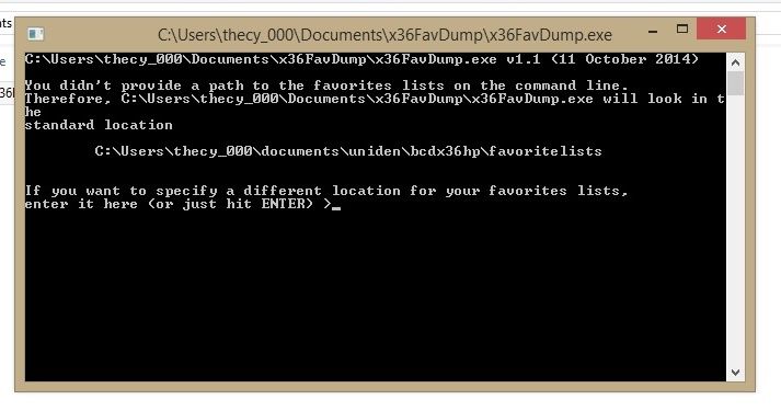

This is what I'm getting when I double click the icon for the program...
troymail
Silent Key
9,981
Supply (Lockwood Inlet area), NC
Either I'm having brain farts or I am too stupid to figure this out LOL.
Is that the correct path/directory for your favorites lists?
If so, when you hit enter (accepting the default location/directory) the program should end like what is shown in this image.
Obviously I'm not using the correct path because when I press ENTER right after opening the program with the default, I get nothing. No messages, no files on desktop, just a whole lot of nothing. And no matter what path I do put in there, I get no results.
I know I'm doing something wrong in regards to the path, but I can't seem to figure out how to get the correct path entered in.
