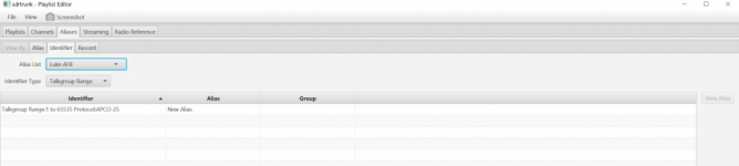

Control channels are entered in the Playlist Channel tab, Then in the Aliases tab create an alias list with a TG range of 1-65535 (Add Identifier, APCO-P25, Talkgroup Range) . To listen to everything that is not encrypted be sure to enable Listen when you create the alias list. By default, SDRTrunk will not listen to a talkgroup unless it exists in the alias list.

2] In the Alias tab, I've created a Luke AFB Alias, with the identifier settings you noted above.

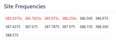

Under Playlists go into the Channels tab and enter all the site info for Luke which among other things includes the Control Channel Frequencies, see example for my local system below --
In your case you need to enter all 4 of the Control Channels that are in Red in the database entry --
