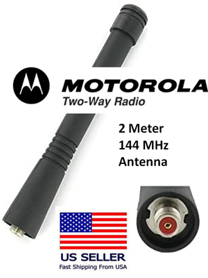

Motorola PMPD4067C IS another good antenna for the HT1000, covers 136 to 147, Shorter at 6 3/4 inches.
