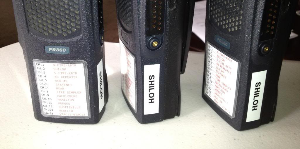

A combination of the above
Take a look at the picture of the Shiloh radios.
I use labels like those, and stick them on with a long piece of 2" packing tape, wrap the tape around the radio, and trim it with a razor knife even with the edge between the radio and battery.
And press it down real good.
Got a hundred running around like that, and they seem to be staying put.
