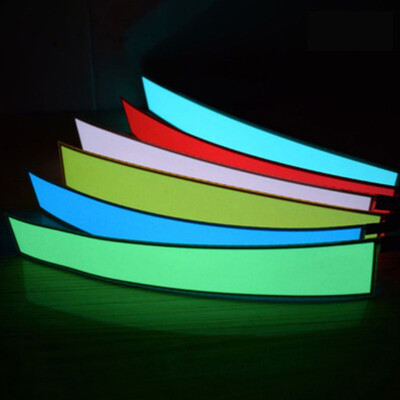

I have two Pro-2006's that work fine but the screen light needs to be replaced in both. Can you PM me and tell me where I can get the new screen lights, and how to replace the old ones?
this is the screen i got ... ice blue color as for doing it there is a good vid on youtube explaining it will make it sound hard its not

Thanks for the link and explanation... my nephew has a 2004 he's not using, and doesn't appreciate. Think I'll see if I can give it a new home.
for sure 2004 is a great radio .. and like i said was way easier as i didnt even have to get the solder gun out. the 2004 2005 and 2006 pretty much are the same as for the light
