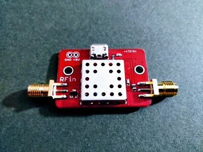

FM broadcast are so close in frequency to the airband that a FM trapfilter often are needed.
You can order a combined airband filter and LNA but then you can't use the LNA for anything else. I use a FM trapfilter and LNA and then a splitter with 6 outputs to different scanners and receivers that receives everything between 60MHz and 500MHz, that's the frequency range where there are radio communications in my country. The attenuation from the splitter seems to be enough to not cause problem to any of my scanners.
A combined $30 FM trap filter and low noise LNA
A combined $50 airband filter and low noise LNA
Remember that these amplifiers have a 20dB gain and will kill any scanners reception. You will have to attenuate at least 10dB. Using an adjustable 0-20dB attenuator will let you listen to a constant transmission like ATIS and dial in the best reception.

Thanks Ubbe:
I'll try to add the FM trap to the wideband LNA and may be latter the specific for airband. Good idea that of the splitter with several different tuned LNAs.
