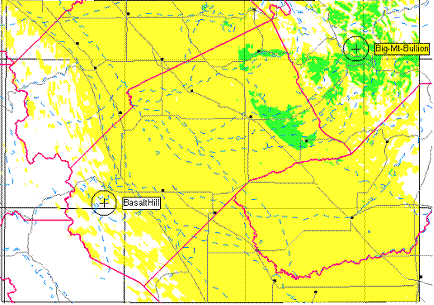

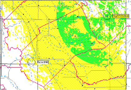

Well, I will take issue that narrowband "is not a bad thing". FRS is intermittent interference but the narrowband coverage penalty is a very real and permanent thing. GMRS is a high performance service.
There was never any mandate to narrow band GMRS nor would it accomplish anything. The reason Midland is producing CRAPPY GMRS radios is because they can simply design an FRS radio and program GMRS frequencies into it. They use FRS receiver filters and don't bother with putting both narrow and wide filters in the radio to save money. The consumer is unaware and they can get away with it.
I am making it my task to educate the masses. Tilting at wind mills, but in short time the market will be flooded with crap.
See these maps. The green is "good" coverage"
Wideband 25 KHz analog FM Coverage:
http://www.leikhim.com/attachments/Image/image020.gif
Narrowband 12.5 KHz analog FM Coverage:
http://www.leikhim.com/attachments/Image/image022.gif
The "maths".
http://www.leikhim.com/page13.php
The GMRS community should be pushing the FCC for a rule amendment to cross certify certain Part 90 radios for operation in Part 95 GMRS.
The "maths".
LEIKHIM AND ASSOCIATES LLC - VHF-UHF Narrowbanding
