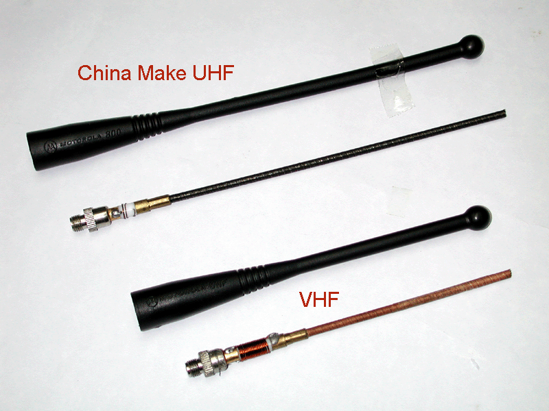

OK super confused now is this a VHF or not??? Motorola OEM VHF-Whip? - Batboard
http://www.hkra.org/radio/cn_ant.gif picture with article

I didn't see a comment referencing this but if you zoom in on the antennas pic you can see where ya labeled UHF. It's hard to see without zooming but when you do you can make out the U

Not sure what picture you mean but it ya mean the one that says China make uhf I didn't make that picture.
