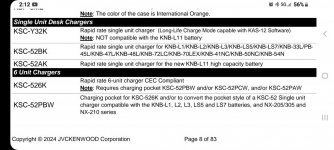

Ksc-32, told this charger won't work if the L11 won't fit. KSC-52 with the AK (for the L11) cup.
Ksc52 BK (cup) standard L1, 2, 3 batteries and the nx-x00 batteries.
Note, can can order the A and B cups separately for the 52 charger.
