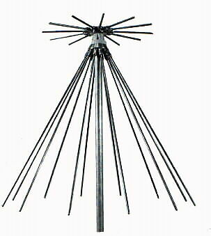

I guess this is what everything has come to, you click for it on Ebay. At least you can see the current prices here which were not available on their web site.
Looks like prices have gone up over the years.

I see the price between the 100-800MHz and 150-1200MHZ version are huge for only a little difference in aluminum. I wonder if the 100-800MHz version now has a machined Rexolite insulator instead of the old ceramic one. Kreco made some 100-?? MHz Discones for Harris that had Rexolite insulators and were black powder coated. Anyone bought one of these lately?

Here is my Harris branded military contract Discone made by Kreco. This one has the Rexolite hub insulator and it was given a gold chromate conversion coat (Alodine) for corrosion protection then black power coated. Its real pretty. I also have a regular 100-800MHz version on the roof and a brand new spare.
Hopefully the pictures will show the quality of a Kreco for the non believers.

I swept my 100-800MHz bare aluminum version with porcelain insulator from 100MHz to 1GHz. It was possibly too close to a big metal umbrella and some other metal stuff but the plot is not too bad. The 5th line up from the bottom is 2:1 and one narrow frequency range around 447MHz peaked at 2.3:1, otherwise the majority is well below 2:1. Feedline was 10ft of 1/4" Heliax.
I would have swept my Harris contract version, black powder coated with Rexolite insulator, but after assembling these 24 elements then having to take most of it apart to get it through a door and putting it back together, I didn't feel like assembling another complete antenna.
