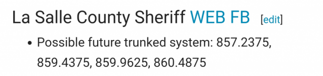

After a few weeks and a few long days with dsdplus and the help of some great people on this forum. We have identified the Tier III system Lasalle Sheriff has switched over too. This is a new site coming off the sheridan tower( cap+ original site.) We are still in the progress trying to figure out any more sites like site 7( Utica or Ottawa) To my knowledge the cap+ system is still in use by lasalle county highway, ready mix and csx railroad. the Tgs i monitor anyways and heard them as of recent using the cap+ system.
