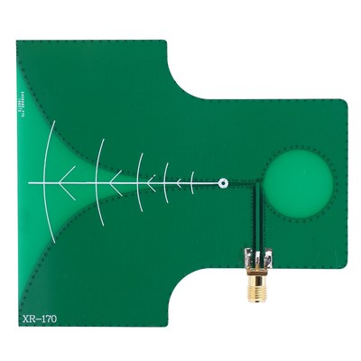

Also consider Vivaldi antennas like these:
I installed these in a plactic clip board similar to these:
I removed the the metal parts including the clip and added connector to the outside. You could also put the cheap log periodics on eBay also in these.

For EMI/interference hunting you will need an antenna which can cover a much wider range of frequencies, possibly several. In this case you are almost always quite close to the source so coupling is more important than directionality of the antenna, although directional antennas can be very useful to determine the area to look in. For this I would suggest a set of cheap wideband (low directivity/sensitivity) antennas like Vivaldis or LPDAs, although these get quite large at low frequencies...however, as I mentioned, the raw performance of the antenna isn't actually that important and a coupling loop can be more useful in circumstances when you are wafting around units to see if they are generating the noise.

I would not bother with the Vivaldi antennas above as they will not be very directional at the lower frequency ranges. For the OPs needs I would recommend a fixed freq Yagi for 433MHz and a log periodic from Kent Britain to cover 2.4 and 5.8GHz WiFi. You can find cheap Yagi‘s on eBay and here is a link to Kent’s antennas. I would order a model with connector installed.
