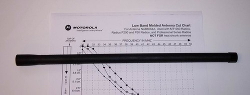

I use the Motorola NAB6064 Ht antenna from the Mt1000/p200/ht750 low band radio series with the antenna stud attached to a Stud to BNC mount adapter that I found online somewhere that I can't remember now wher I found it. Along with a short counterpoise wire of around 16 inches attached to my low band receiver/scanner with the NAB6064 cut to 42 Mhz mine works fine for CHP use.
