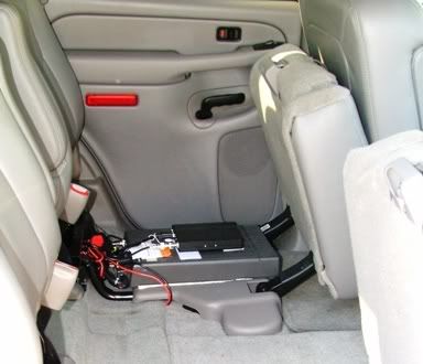

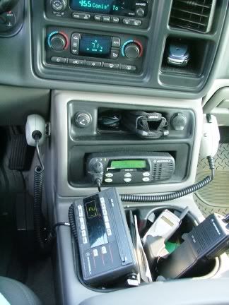

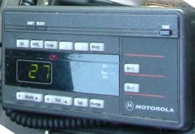

At least that's how it works on my scan head....See it at the link....
http://i182.photobucket.com/albums/x127/Bulb59/MotorolaMaratrac.jpg
http://i182.photobucket.com/albums/x127/Bulb59/Maratrac.jpg
http://i182.photobucket.com/albums/x127/Bulb59/Tahoe2.jpg

If it's an A7 and it's scanning, short press the SCAN button to stop scanning, then press and hold SCAN until the radio beeps and the Scan light starts to blink rapidly to tell you that you're in Scan Programming Mode. A channel number will show in the display, and the Scan Status (Priority or Non-Priority) light on the right side of the display window will indicate which scan status the displayed channel has (Priority, Non-Priority, none).
