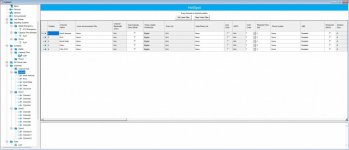

Hello! I just picked up a used SL7550 today and I am programming it with CPS16. I know enough to get in trouble when it comes to commercial radios, but I can not figure this one out.
I have created Zones in my CPS and write them to my SL7550. Once on the 7550 the cannels and Frequencies I programmed are there but they are all in a list, basically channelized. I have no zones, even though I created the zones in the CPS.
When I go to menu and scroll there is no option for zone. I programmed button P1 to be set up for zone selection. It is there and it says Zone but it doesn't do anything when I press it. If I change the command of P1 it works, so I know its not a button issue.
No sure if anyone has ever run into this or not.
Another note it doesn't charge with a standard USB Micro cable and block, so I will have to purchase one of those as well.
Overall a good little radio, but a frustrating day for me in the sense of programming only to be disappointed (haha).

Glad that was it! It's tripped up numerous folks in the past, probably because those particular checkbox functions aren't immediately obvious.
